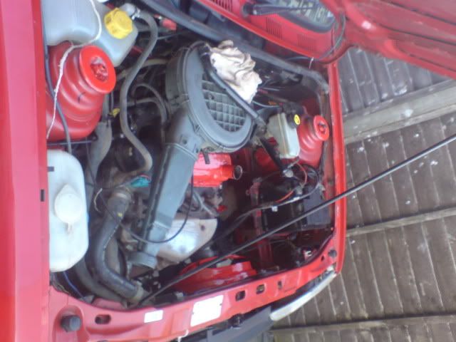

i used a washer bottle off a suzuki sj410/sj413 from down the scrapyard.
Cost me £2 and its a lot more powerful, just bolts to the inner skin of the wing.. Pic below..
