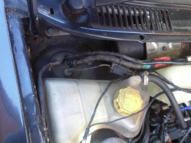

i need to get my oil gauge wiers though to the engine bay where is a hole i can use i coulnot find any?

behind the coolant header tank there is a large gromet, and on the otherside of the car too, its behind the metal panel which separates the engine bay and the wiper motor section (this panel has been removed on mine)
Will
