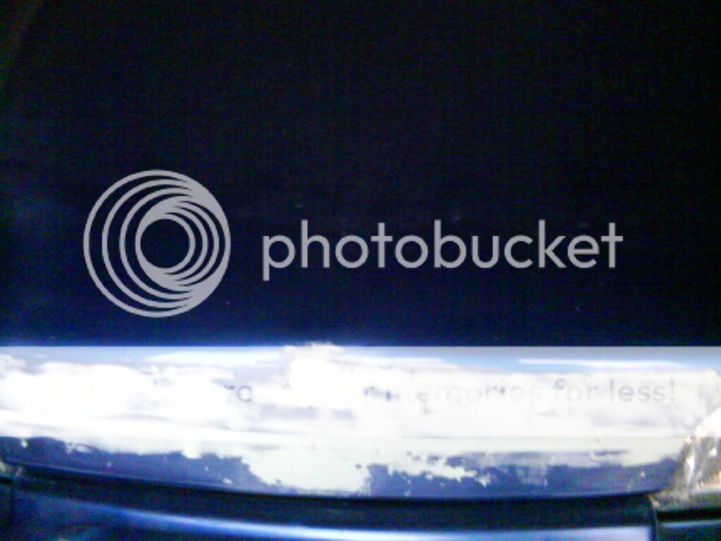

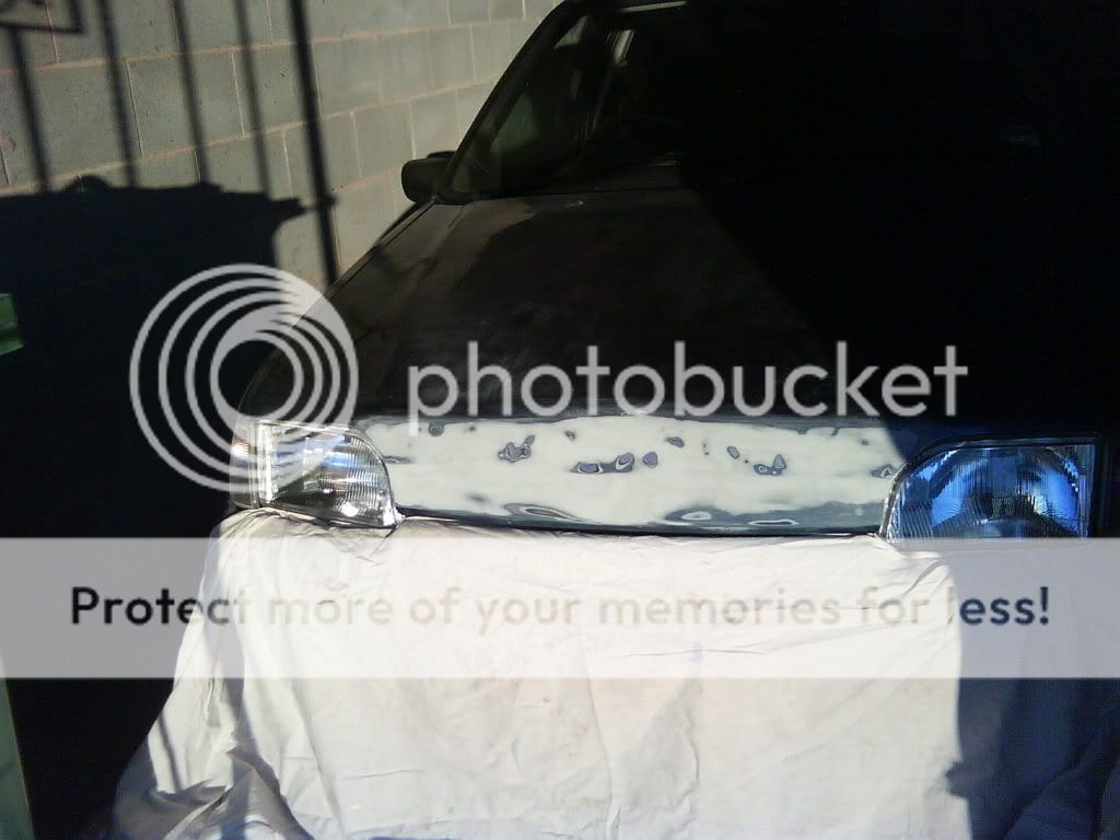

Hi everyone,
Well, I have finally made the time to show you all my bonnet filling. I haven't been able to complete it yet as I keep getting rained off or it's just sooooo cold.
It's my first ever attempt so please be nice!

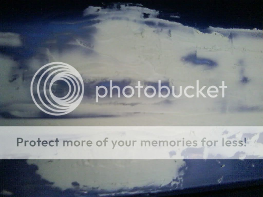

Here is how bad the dints were before:

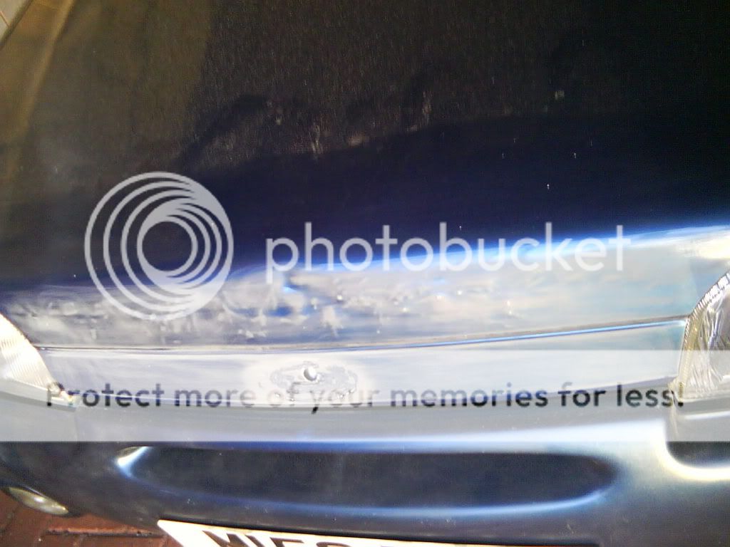

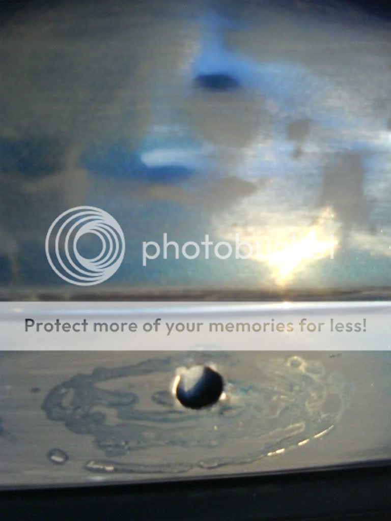

then I debadged and smoothed ready for body filling:

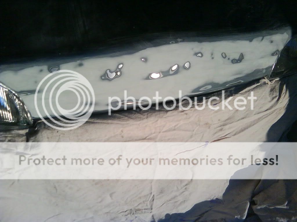

then I chucked in loads of filler! Lovely!

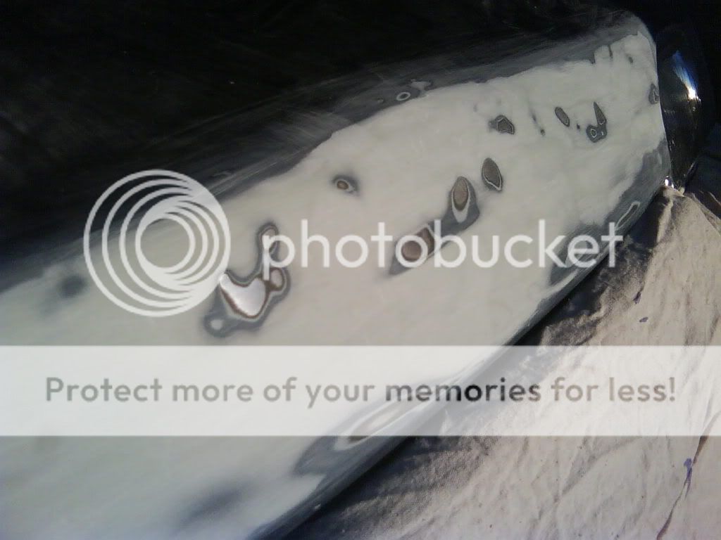

Then I sanded and re-filled, then sanded again:
Then I primed:

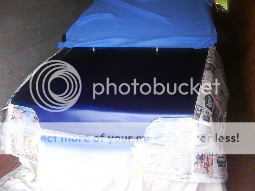

and finally put a few coats of paint and cut back in between:
I haven't been able to put the laquer on due to the weather so this is how she looks for now.
What do you think, any recommendations?
Little Sister
PostPosted: Sun Nov 09, 2008 7:00 pm
looks like a pretty good match. if you can get a space heater and somewhere under cover then laquer it and wet flat and polish it. otherwise wait till the warmer weather is here and do it then.
Jam.
PostPosted: Sun Nov 09, 2008 7:47 pm
looks like you need to put a couple of more layers of paint on just above where the hole was, can see a slight arch where its been filled and sanded!!!!
other than that its a good attempt :thumbsup:
PostPosted: Sun Nov 09, 2008 8:44 pm
looking good :thumbsup: What Stunning said would be good just to try get as thick paint as possible...as that area will be prone to stone chips
As Jam said...if you can't get somewhere under cover with a heater....it would be best to wait till warmer weather as lacquer can go a bit funny in the cold
Remember though, lacquer is often considered the hardest stage....so make sure you take your time and don't apply too thick layers....may be best keying back some of the lacquer above the area you have painted...then it will blend better if you go a bit above the paint layer
Good luck :)

PostPosted: Tue Nov 18, 2008 3:25 pm
actually looking at them again, did you primer it first as it looks like just blue paint straight onto the filler!!!! :)
PostPosted: Wed Nov 19, 2008 7:59 am
Picture showed the priming stage to be blue, unless thats an error on the pictures?
High build primer is god after fillering :thumbsup:

Hi everyone,
I used Hammerite Blue primer as I thought it would be easier to then but the blue paint on. I have done a few little areas around the car already with white primer and it took forever to cover it. It's blooming freezing so I think I will wait to the better weather.
