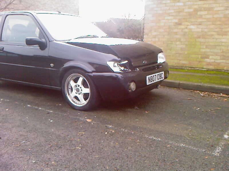

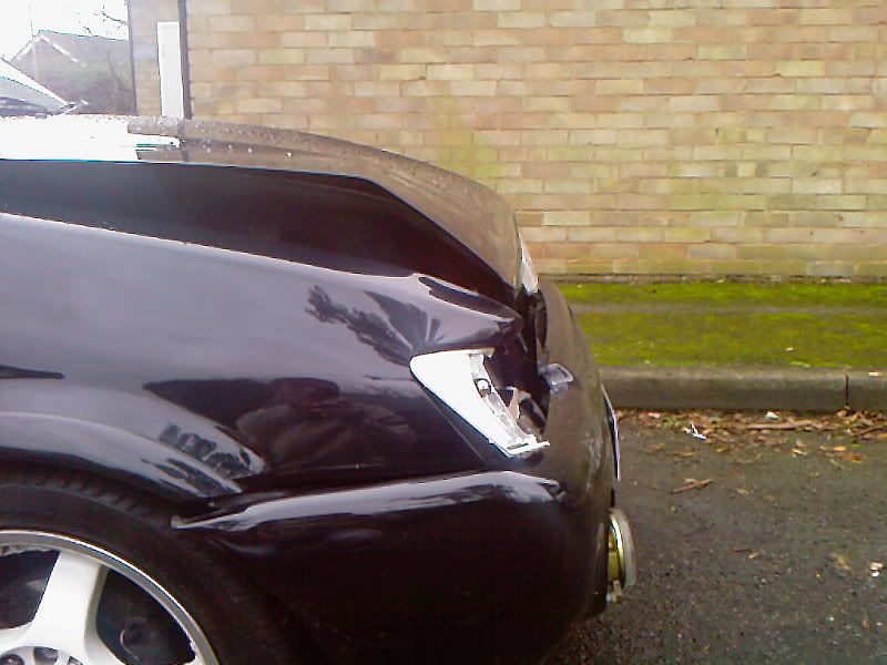

the pictures......
im not sure what to think of it really....
hope this pics are the right ones
seems like the bumper has come off on one side, not sure the extent of the damage to the bracket?
rad is now banana shaped, lower valance has took a good whack, and slam panel seems to have had a good one too...
drivers side wing was been pushed down where the indicator should go..
what else should i check?
cheers

Bloody hell Andy, did you launch your car into the back of the other one? :o
I can see that the wings have been pushed back a bit aswell, as the line between them and the doors has decreased. It's one of those that looks worse than it is though, and any decent bodyshop should be able to fix it and you'd probably never know.
Have a check on the underneath and see if anything looks bent out of shape, or broke. Antiroll bar, lower arms, check the suspension is still straight. I doubt any would be bad though. It's hard to tell with everything still on the car aswell though. I think your best bet is taking it for a quote, or take some pictures into a bodyshop if you can't get the car there and explain what happened. They might give you a rough quote, or they might say not to bother.
Remind them that you may be able to get most parts for cheap, so it may just be labour costs and spraying up. That way aswell, you can accumulate your parts as and when you have the money, then save up a bit for the job if you have a rough price.
And dont forget, with the car sitting there for a while bare metal will rust so if there's anything salvageable you might want to protect anything exposed on it. :)
