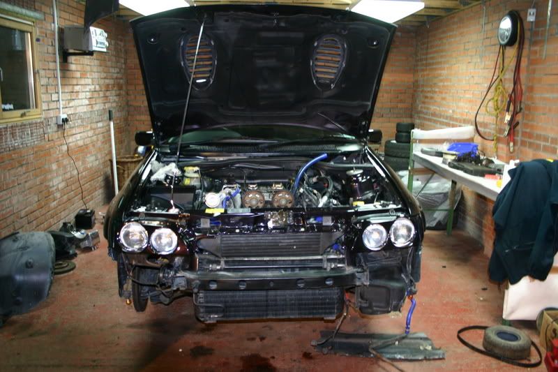

PostPosted: Thu Mar 15, 2012 1:52 pm
And heres me thinking I had a cool garage :lol:
Although it doesnt look much like this now, because currently its a bit of a mess... the fiesta still fits in there no problem. I've even got my original bonnet on the left side of the wall now, can still open and close the drivers door enough to get in and out of the car with ease.
I guess its all to do with how you use the space. I might go sort it out today thinking about it, the cleaner and tidier it is the happier I will be lol.
