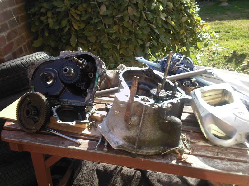

So, i fancied an LSD this month, my gearbox is knackered in the fiesta apparently pulling your friend all the way from southend on sea to south wales using only A roads has a negative effect, finally busting out an end of all revs and 5th gead wheelspin in the ice will cook your bearings on the end of the main shaft and around the diff,
i bought a gearbox off "cookie" and i got a limited slip diff of my mate (from an s2 escort turbo),
so i figured great, open the gearbox pull it appart, out with the slipp diff in with the limited slip diff
oh boy was i wrong,
so firstly removing the oil from the box easy, just pop out the remainders of any cv joints / drive shafts, rest the box on its side over a wall and catch dripping oil in a biscuit tub
couple hours later i stopped dripping, time to dismantle,
whip off the very outer cover, just a few not so tight bolts,
here you will find mr 5th gear and syncro
undo a torx screw here take off a springy selector thing there, bash out a circlip there minding not to blind you self
voila your just left with one last cog which seems to be very stubborn,
so a quick little trip down to halfords to grab a gear puller,
back home to the gearbox assemble the gear puller it has 8 different combinations, none of them fit,
time to make my own combination, (just use 2 legs) the gear-puller drops off, back to 3 legs flip one upside down great it fits, get the blow tourche out heat the cog up and hopefully it will just slip off,
wrong! the gear puller snaps game over for tongiht the gearbox wins,
the next day back to halfords with the receit hello this tool broke id like another,
back to the gearbox, again this tool doesnt fit, out comes the angle grinder 5 minutes later the tool fits, out with the blow touch again, and pop off comes 5th gear,
finally i can serperate the middle case to reveal the gears, and the standard diff,
a close inspection of the magnet reveals that this gearbox has had a few crunches as theres a couple of teeth stuck to it haha, i hope there not important :D
so now im thinking great out with the old diff in with the lsd,
i lift up all the gears and selector and manage to wiggle the standard diff out without upsetting any of the gear selectors and squeeze the lsd in, but it just doesn't seem to fit right (its a series 2 escort turbo lsd it has 8 bolts its been in a fiesta box before it should fit), its grinding on the case as i turn all the gears around,
out with all the gears and selectors a couple of circlips here and a tug there, the lsd diff is out compare it to the original diff and bugger the bearings are smaller on the lsd,
a quick call to newoods
"Newood Transmissions - Essex Gearbox repairs specialists
Automatic & Manual Gearboxes Exchanged, Reconditioned Units, Axle / Overdrive Specialists, Clutches Fitted, Differentials, Prestige Car Specialists. gearbox ...
http://www.newoodtransmissions.co.uk/ -"
confirms that there are 2 types of bearings big ones and small ones,
now he has the gearbox its his problem to make the diff fit
apparently you cant just take the bearings from one diff and fit them to another diff, you have to cut the old ones off and press the new ones on,
also you cant just do that, you also have to re-shim the diff so that it sits snug in the box otherwise "it will wobble around in there"
damnit i was hoping the strip the box fit the diff put it back together jack the car up take the old box off and have lsd fitted by this evening argh
TBC..........

i am still baffled by this gearbox, i have now worked out how all the gear selectors go back together, and i have found that if i put it in reverse and put it back together (minus 5th gear) gears 1 2 3 4 can be selected, i can also engage reverse however,
when i put the box into neutral the diff still spins around when you turn the main shaft,
(maybe the gears are still slightly engaged cause its all kinda loose and they have been washed when i got the diff shimmed)
also when i put the box into reverse i cant seem to turn the box round as in it just seems wedged?
i have put some some pics maybe someone can spot the error, it looks exactly like all the other images of gearboxes but it just seems to be wedged,
Maybe someone can shed some light on the problem, the only thing i can possibly think of is that maybe because i havent pulled it all together tight the syncros haven't disengaged properly on the gears?
which could explain why reverse seemed wedged, argh

Finally the Box is rebuilt with shiney new bearings :D
It seems that i was correct, when i was engagin the gears without the middle casing on there was to much play as the housings hold everything nice and close, so as a result it wasnt disengaging one of the gears as i was trying another gear, this created a confict when i engaged reverse as i was trying to spin the mainshaft in the oppostire direction using the reverse gear yet another gear probably 1st was still partially engaged, anyways, the box is back together, all gears can be selected however reverse seems a little iffy, the box seems stiff to, probably cause the guys at newood completly cleaned the box out and degreased everything (as you can kidna see by the pics)
so heres what i learnt haha
To remove the 5th gear from an ib5 gearbox either get the correct 5th gear puller from ford or buy a halfords gear puller and use an angle grinder to shave a few mm of the bottom of the legs, i used a cloth between the two 5th gear cogs to hold it still whilst i was doing up the gear puller i also used a blow tourch on the cog up as it comes off easier (some how)
circlip pliers are very handy if like me youve lost yours, get 2 pairs of pliers handy and a swiss army knife, using a series of combinations all the C clips will come off eventually, just make sure to catch them
once you have cracked the box open to reveal the gooey goodness of ancient gearbox oil and shards of gears, you wil find a magnet will shards of reverse and 5th gear attached to it, take this out and clean it haha.
the easiest was to get all the gears out is to remove the 2 c clips on the gear selector shaft and pull the whole lot out, (its heavy ish)
finally the diff comes out you can just pick it up :D
if you are fitting an lsd like me you need to check the bearings are the right size there are 2 types small ones and big ones,
if you have the wrong bearings, you need to angle grind them off and press new ones on, but its not that simple the new diff will need shimming out to fit the box else your diff will just wobble about (this is what the guy at the transmission place told me)
for as little as £50 this service can be done just take your 2 big casings and 2 diffs down to your local transmission place and £50 its best to get this done by the pro's as they know what there doing,
Things to remember when re-assembling the box,
take note of where everything went, (i didnt so i wasnt sure but after a quick google images i found what i was looking for)
the gear linkage probably wont work very well when the casing is off so as long as it looks exacly how it did when you took it appart it will probably be fine when you put it back together.
engage reverse gear when you put the box together and do not let the selector shaft move around if it moves you could end up loosing reverse (my friend did this so i paid extra attention to reverse) i actually used mole grips on the little selecto stub sticking out the box to make sure it didnt move,
do not reuse the old gaskets they are probably knackered for £8 new ones can be had off ebay
make sure to put all circlips back on and double check the box before putting 5th back on
do not let the springs ping out of the 5th gear synco they are a pain in the arse to get back in
finally when the box is all back together, when you go tp hammer 5th gear back on, support the main shaft underneith with a block of wood or something otherwise you will hammer to crap out of the shaft bearings and probably shorten there life expectancy
I HOPE I NEVER HAVE TO DO THAT AGAIN
