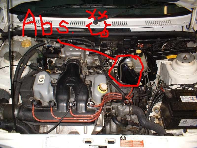

anywho, how can i tell if my Si has ABS? i found the ad for when i bought it ans it said ABS on it, but my ABS light does not come :?
anybody know if i can look at some thing that will tell me it has ABS :?
mods feel free to move this :look:
PostPosted: Fri Dec 09, 2005 1:10 pm
Have a look at your brake fluid reservoir. If there are a few pipes coming off it more so than the pic below, then yes it does.
PostPosted: Fri Dec 09, 2005 1:52 pm
correct that i seem to have the same amount of pipes on mine :look:, have you got a clearer pic
i will double check mine tonight again
cheers
PostPosted: Fri Dec 09, 2005 5:09 pm
Get your bonce under the car and look on the drive shaft. If its got a belt and a large cover around the shaft then its got ABS.
