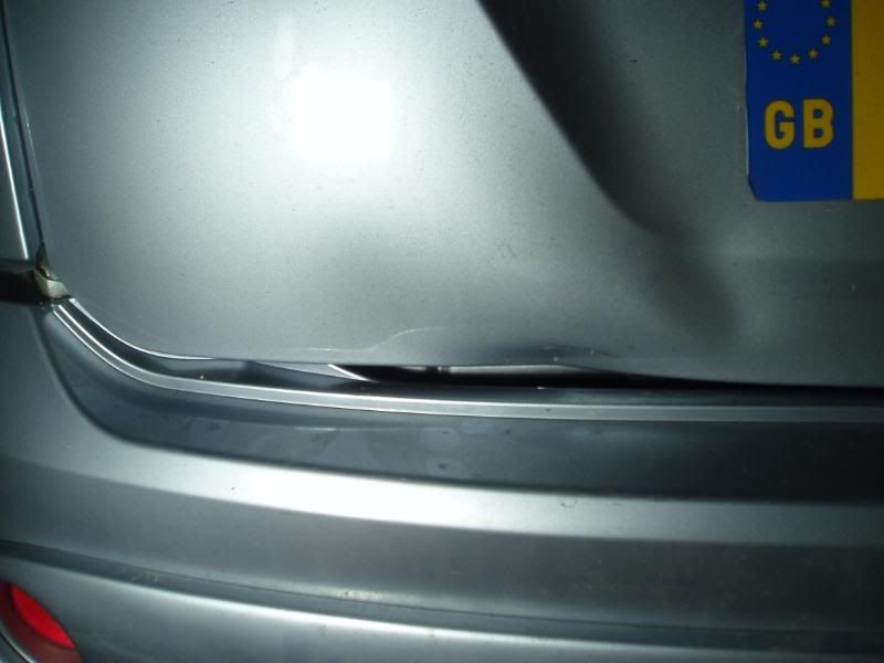

Damage to my Fiesta Wolf:

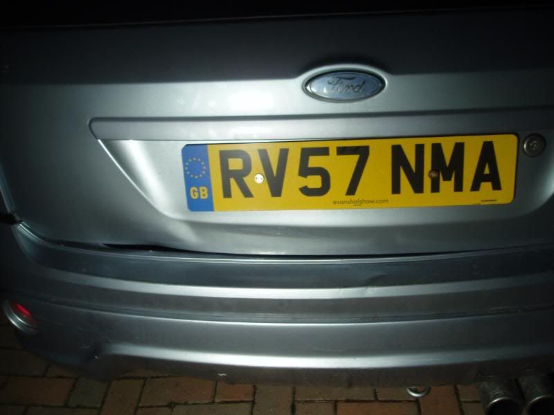

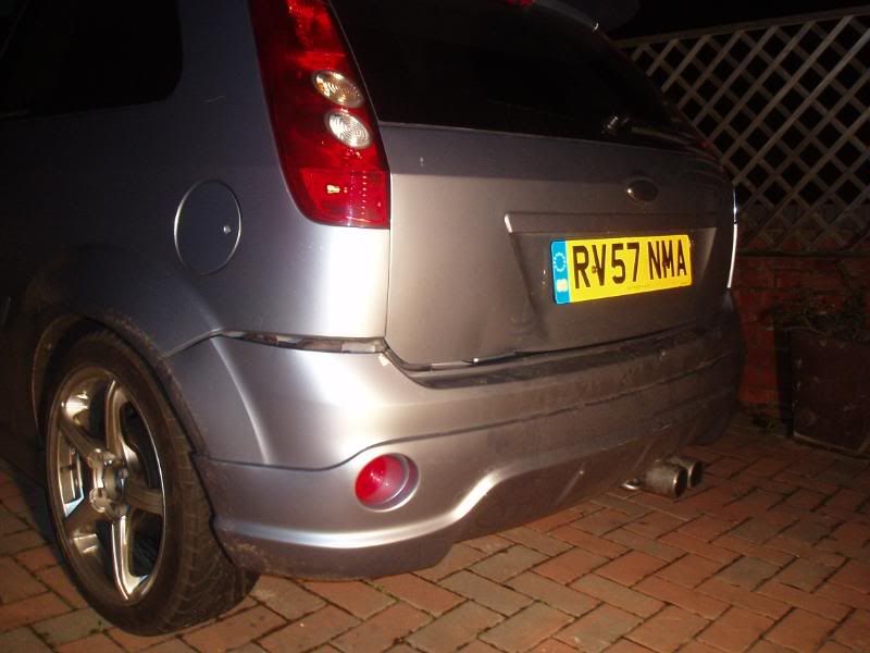

Tailgate pushed back, and dented on left hand side and won't open (has Ford privacy glass and ST spoiler bonded on as standard)
Left hand side
Right hand side

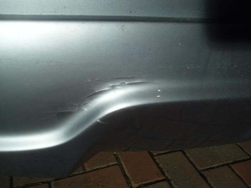

The rear bumper has come away on the left hand side and raised in the middle. The Wolf rear apron (£200 + shipping from Germany) is also cracked

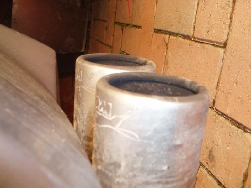

The Wolf twin exhaust needs replacing - the left hand tip has been pushed back (£375 + shipping from Germany)

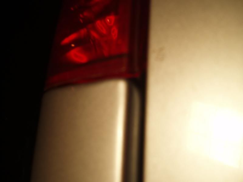

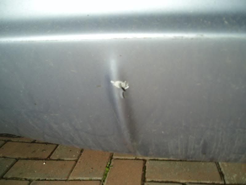

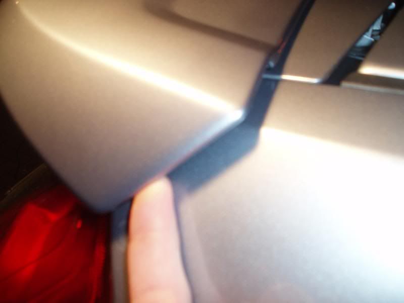

Where the boot has shifted in and to the left (passenger side) it has affected the rear 1/4 panel that wraps around under the tail light
The bottom corner of the passenger side tail light is chipped (needs a new light)

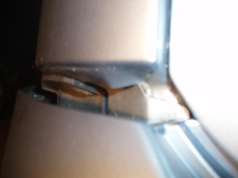

Where the boot has been shifted to the left the top of thew ST spoiler is sitting on top of the rear 1/4 panel

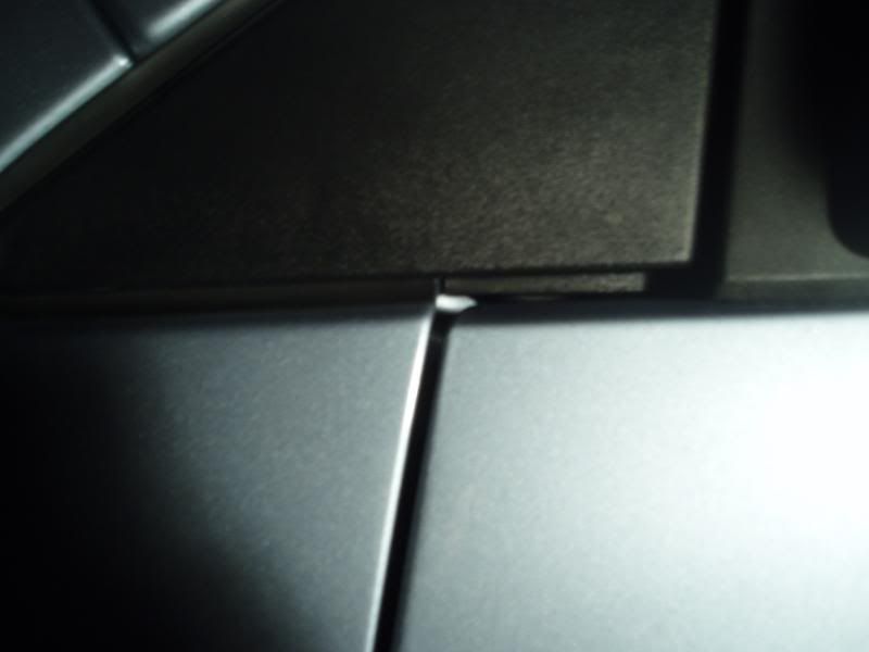

And the panel gap on the roofline (where the rubber is) is wider nearer the boot on the passenger side as opposed to the good side
Good side:
Bad side:

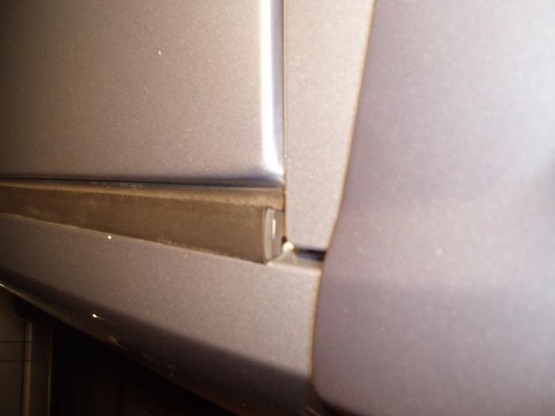

And finally the passenger door has been shunted forwards and the top edge into the car slightly
The top of the door in the above pic should be level with the wing
Sorry for all the pics, but that is all the visible damage - i haven't been able to get in the boot/under the car. To summarise he appears to have hit me at an angle such that the rear has been pushed in and the passenger side of the vehicle shunted forwards and possibly twisted in slightly
So all in all i would just like your opinions as to whether this would be repaired or likely to be written off - i would imagine it's 50/50 myself but i have no idea,
