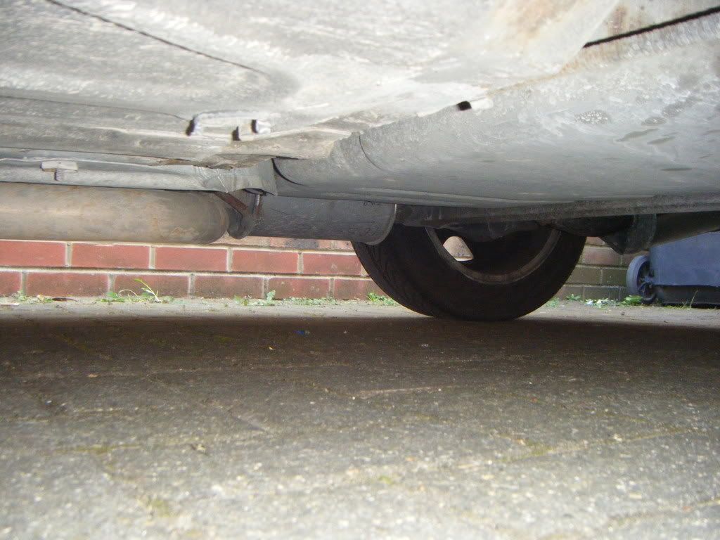

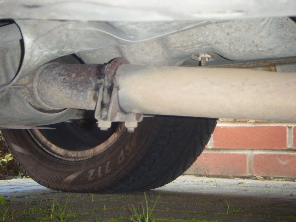

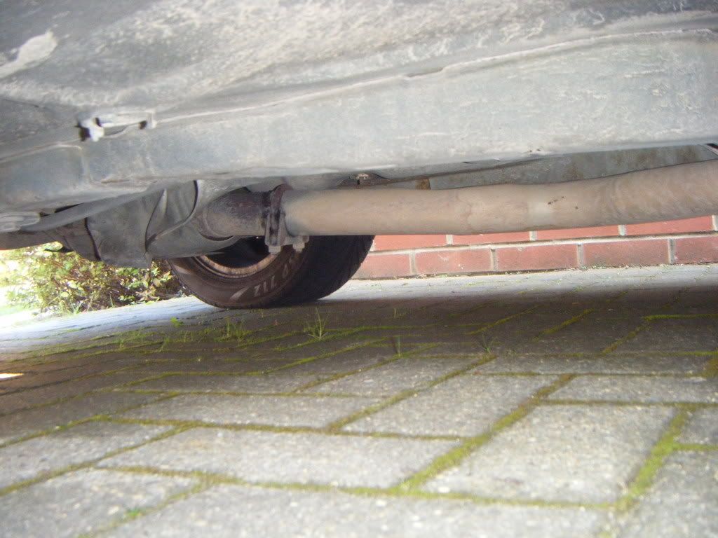

Need some advice really, my exaust is obviously quite low and im wondering why tbh, everytime i go over a hump or anything you can hear it scratch near enough every time. cant be good for it. Anyone got any ideas as to what it could be by the pictures???
Thanks guys.
jim

its a common problem on the fiesta because of where the mountings for the exhaust are.
try lossening the clamps ect reposition the exhaust and tighten them up.

as said, loosen the clamp on the cat and make sure the joint is totally lose to move around and then where the exhaust bends around the fule tank put an axel stand under it so it pushes the exhaust up and then retighten the clamp on the cat, you may have to losen the clamp on the backbox too when doing this but just try the one on the cat first as i managed to do it with just that one :) when i did it i was lazy and just layed under the car and used my foot and knee to hold the exhaust up while i retightend the clamp :lol:
just one thing im guessing this isnt a zetec engine fiesta?
