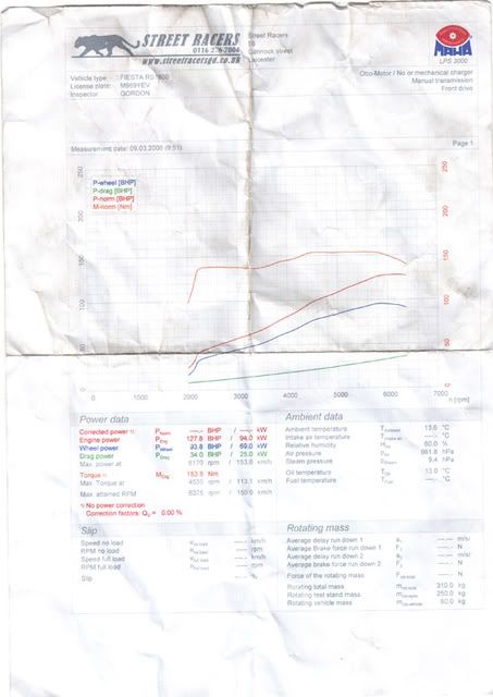

Find my rs1800 graph, most recently posted on petrols thread.

Oh and just for very ROUGH reference.
RS1800
3000rpm - 60bhp
4000rpm - 78bhp
5000rpm - 105bhp
6000rpm - 127.8bhp
6300rpm - 125bhp
RS Turbo
3000rpm - 74bhp
4000rpm - 98bhp
5000rpm - 120bhp
6000rpm - 130bhp
6300rpm - 120bhp
So it really depends on the weight, gearbox ratios, etc, though the turbo has more power low and mid range.
