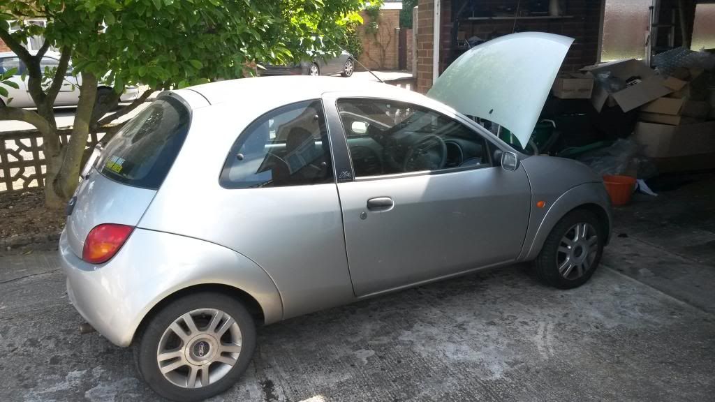

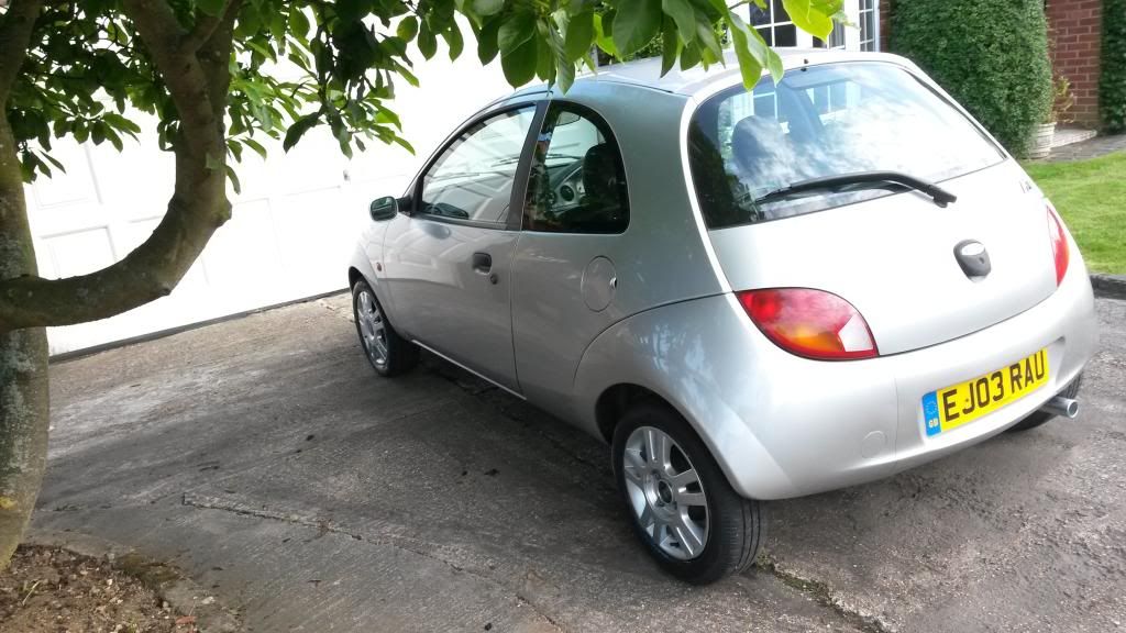

Hi everyone your probably wondering why ive bought a ka, well i about 3 months ago i split with my fiancee after a long relationship :( so to help me get through it i decided to buy this ka luxury to keep me busy just over a month ago from a mates gf for a project to buy and sell but i kinda like it :lol: its a 2003 plate only covered 61k and being the luxury model it has some bits on it with black leather aircon, heated front screen and remote locking :)
I only paid £150 for it but it does need a fair bit of work, it came with 3 months tax but no mot
the headgasket is gone and done internal damage
wishbones are split and have play
top mounts have play
aircon pipe damaged
discs and pads pasts there best

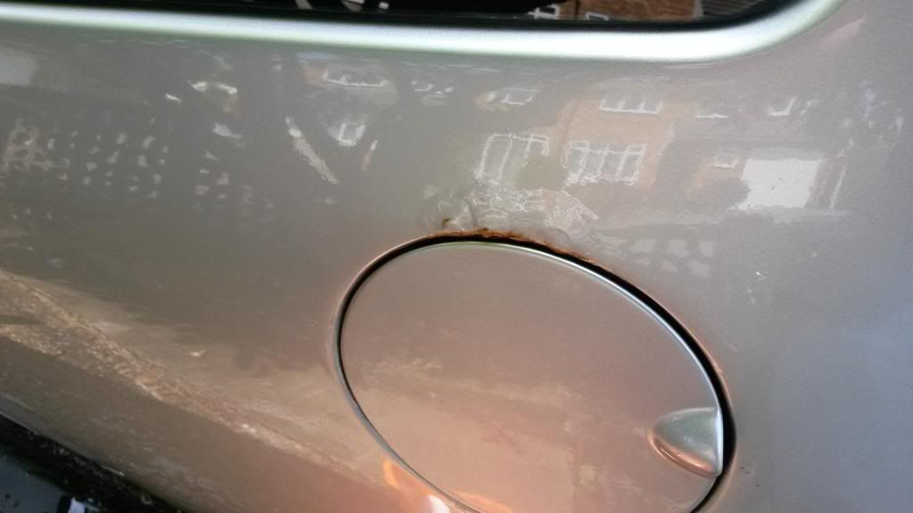

has a small amount of rust above the petrol filler flap
new glovebox
fit new genuine front arch clips
heater control valve
and a few bits of missing trim
and replaced missing alloy wheel cap
and adjust the handbrake
i dont think its been well looked after it was in a sorry state when i got it

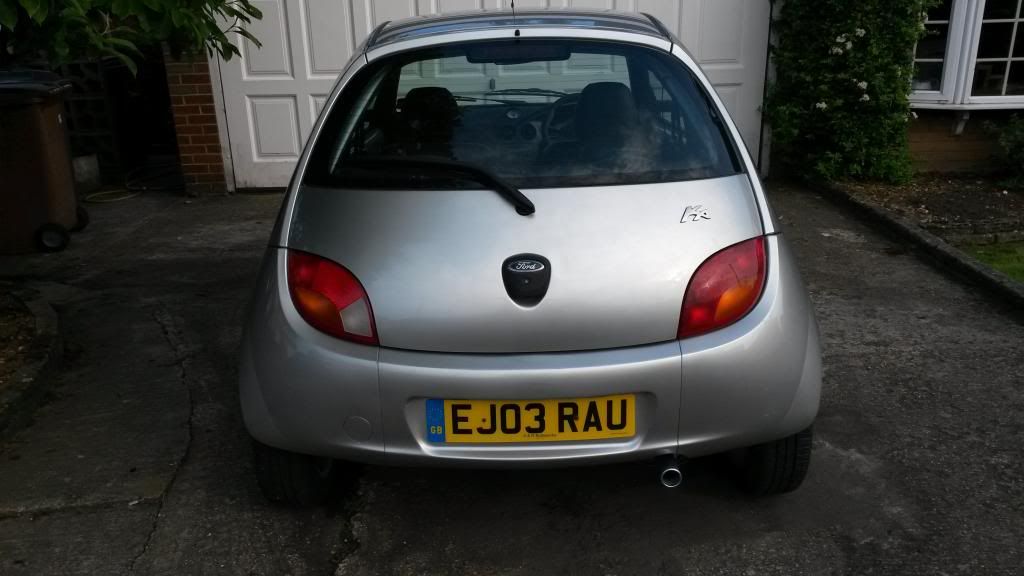

Then i gave it a wheels off clean under the rear arches was very muddy indeed, but the car scrubbed up very well no parking dents its just the scab of rust above the petrol flap that lets it down
Also added a new exhaust trim and replacement ka badge as it was missing

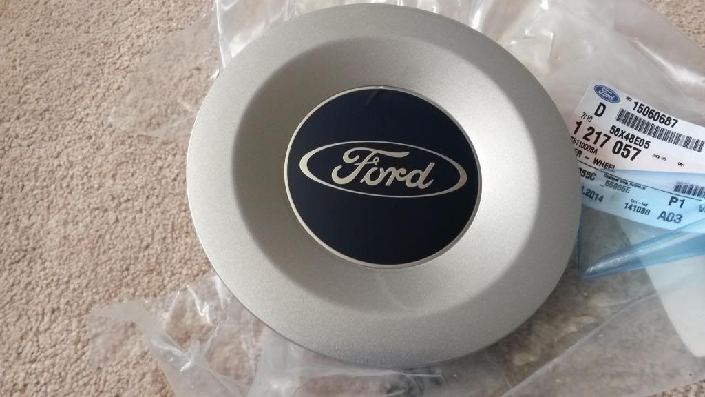

Brand new centre cap bought off ebay for £9.20

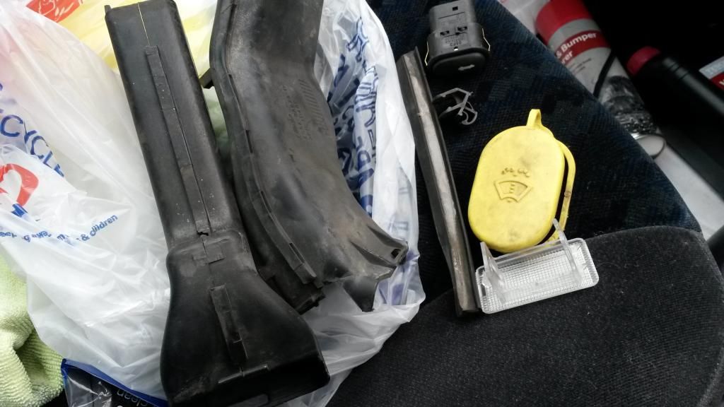

A few bits from the scrap yard to replace the broken and missing items on mine

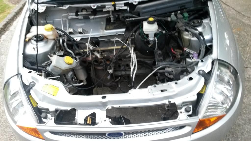

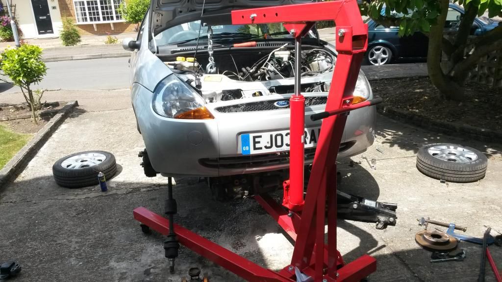

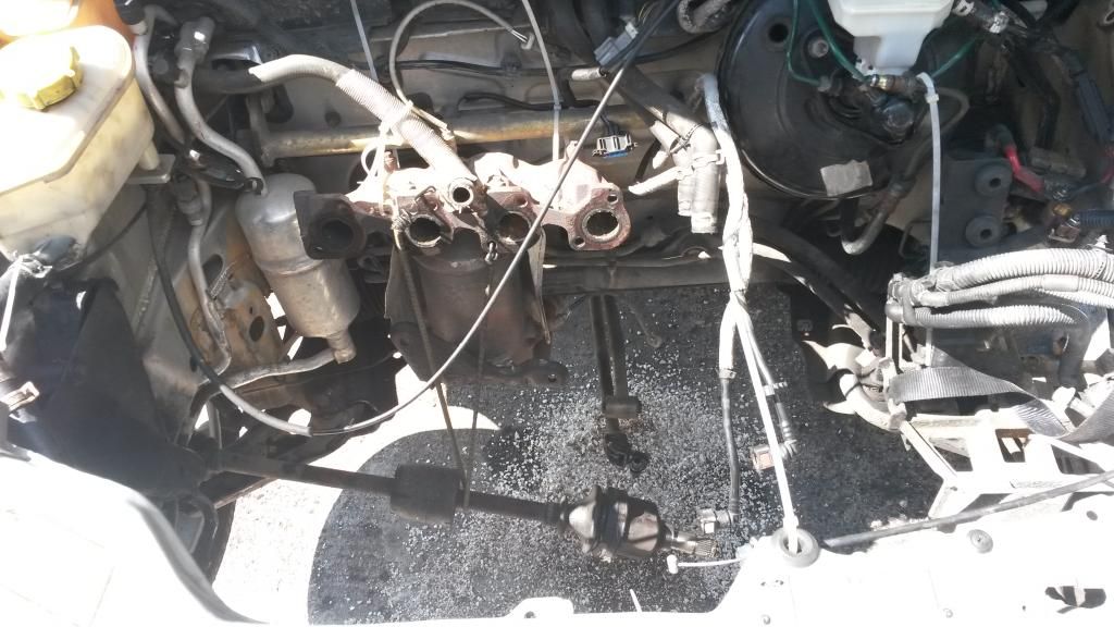

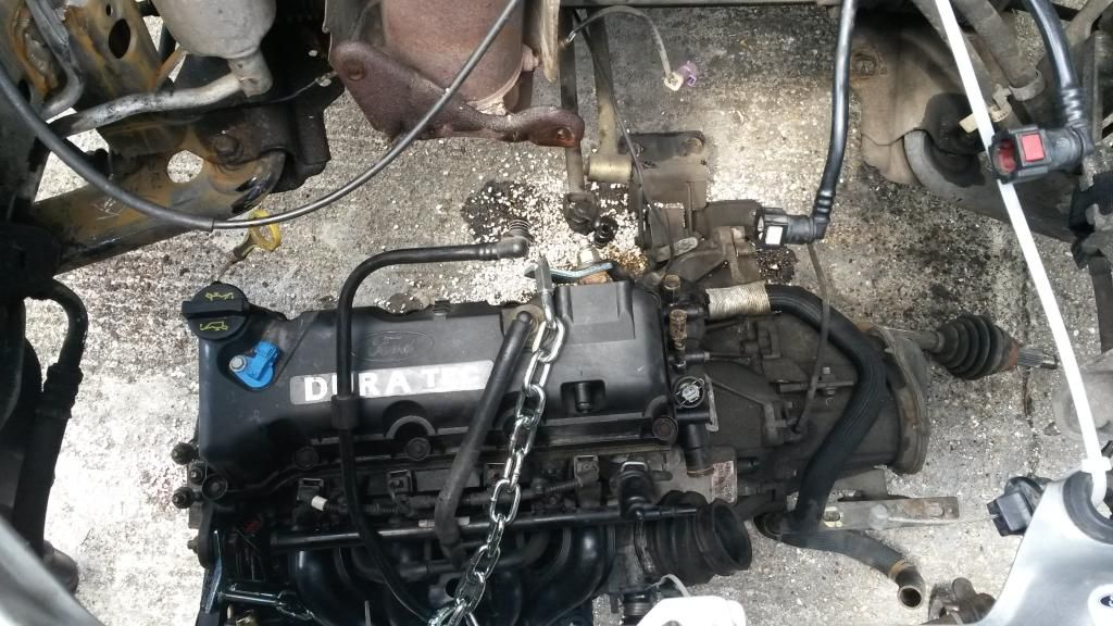

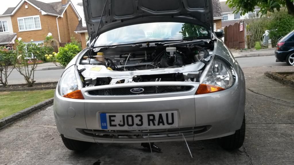

Time to get the engine out as its dead

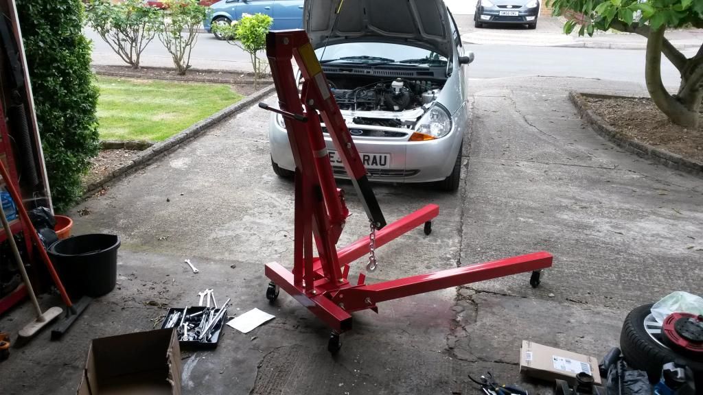

Bought myself a crane as well which really helped
Dirty bay
Cleaned the gearbox up so its nice and clean for when i source a good replacement engine
I couldnt resist but give the engine bay a big clean

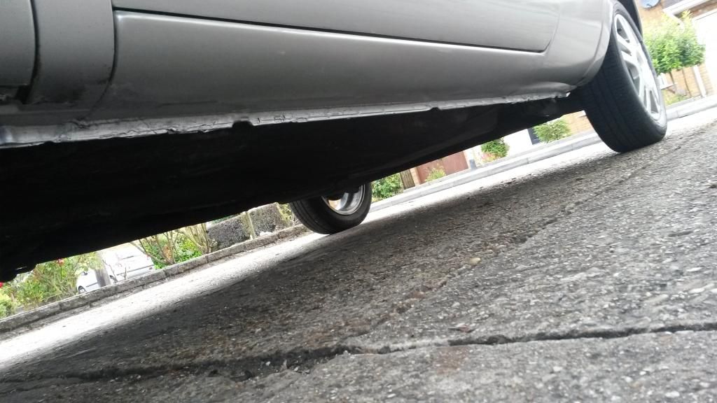

also treated and hammerited some of the surface rust on the sills although there was very little :)

yeh im hoping to possibly get it done next year im going to try amd protect it from the inside the best i can to try and hold it back for now :)

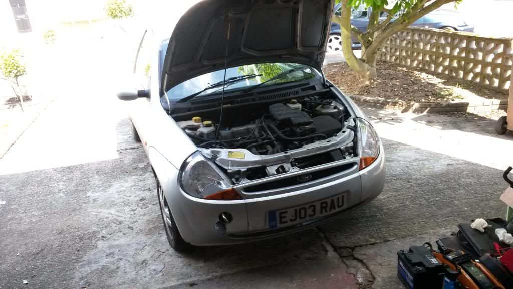

Another update :)
i replaced both wishbones as the bushes where badly split
Waxoyld the floor pan front the back and treated any scabs i saw
Cleaned the interior again and scrubbed all the carpets
Bought a new thermostat housing with new sensor and thermostat

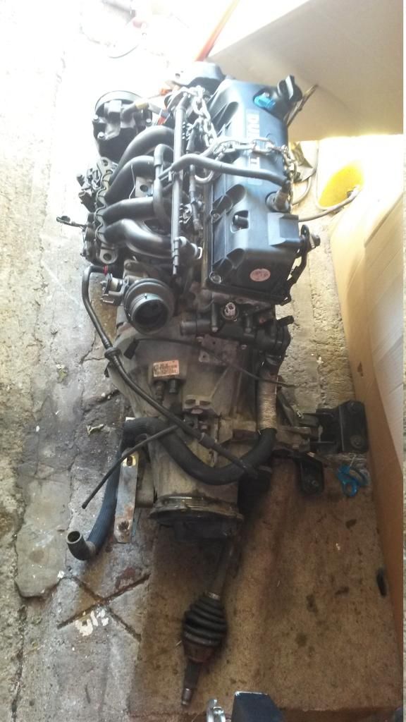

New duratec engine arrived a fiesta mk6 one turned up so has different mounts and cam cover the seller kindly refunded me £30 as it wasnt as described
Flywheel, gearbox, clutch, and slave cylinder fitted
Im hoping to build the rest up this saturday evening and drop it in on sunday all being well, also want to paint a few bits like the driveshafts as i had to replace one as i damaged the cv joint end where the nut goes on and it was cheaper to buy another shaft down the scrappy so has white paint on it, i was going to paint the gearbox but i thought its taking it too far :lol:

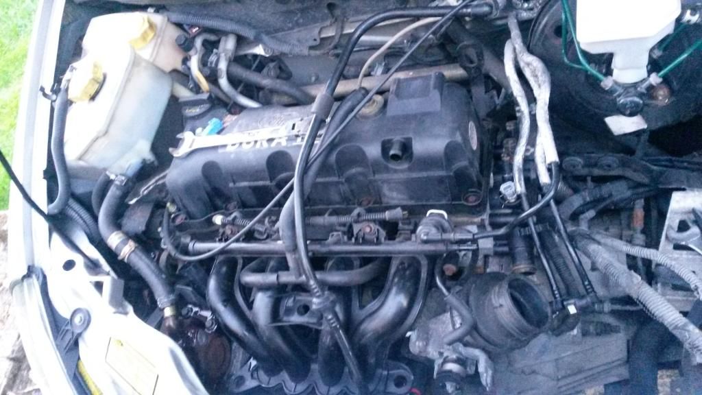

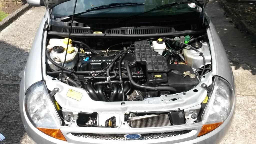

Big update here :)
Painted the gearbox and put the new engine in the car :)
Pic of the stang :)
Also bought a brand new inlet as i noticed a piece of black plastic in cylinder inlet port 1 of the old engine so thought i best put a new one on it
spent all day yesterday on it, finishing it off, but a bit stuck atm as the engine turns over and is getting a spark and fuel but not starting, should be a easy fix im hoping :)
